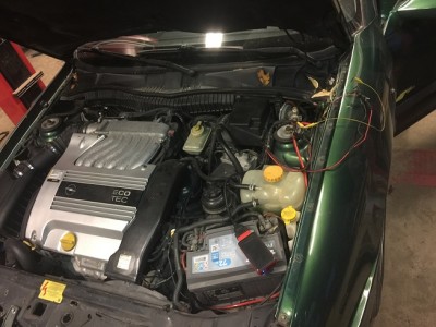

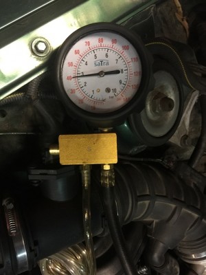

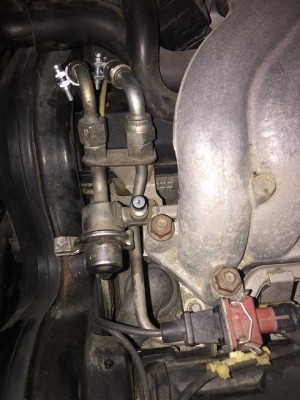

Its been a while since is wrote.

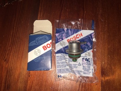

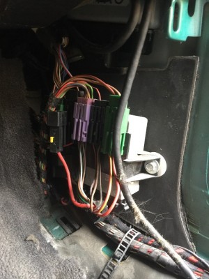

Calibra has still starting problems.
It wont start everytime.So my friend put the diagnostics on and no fault came out.
After that he checked fuel pressure and one problem came out.
Fuel preassure regulator was faulty.So i bought new one.
After that another problem started.Sometimes it wont start after 10 times when i try.

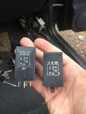

Friends said that maybe its fuel pump relay.So i bought this one new also laecheln.gif
I changed it and it got a little better but still there is a problem when there is a damp weather outside.
Here are couple of pictures.

After change fuel pressure stays at 3 bar.Before it just falled down.

Couple of pictures about the relay.
 Dateigröße:  131.76 KB
 Dateiname: 6.jpg
Old vs new.

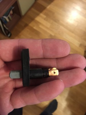

Also cleaned drivers door switch and got it working again.

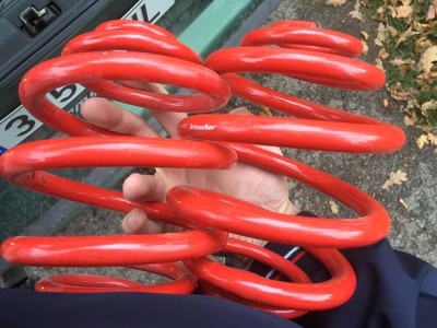

Also Santa brought spare rear springs :D

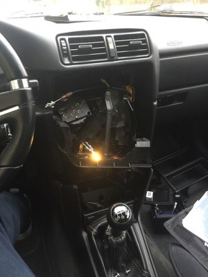

I didint like that the center console heating part was dark,so i took the big job ahead and I dont want to do it anymore.😁
Before and After
 Dateiname: 1.jpg
 Dateigröße:  162.61 KB
 Dateiname: 2.jpg
 Dateigröße:  104.72 KB
 Dateiname: 3.jpg
 Dateigröße:  102.48 KB
meisner
Beiträge: 12758
Danke-Klicks: 336
Beitrag: 759076 Geschrieben: 05.11.2020 - 20:05 Antworten mit Zitat Sende EINEN Danke-Klick für diesen Beitrag Back to top
Fixing this thing can be a real pain in the ass biggrin.gif did it several times. Was not funny lol.gif
Btw: why don't you upload your pictures here on our site wiejetzt1.gif

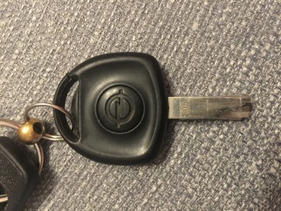

Does anyone has or knows where can i get new blank key with opel logo and bulb place.Thats my primary key but like you see its broken.
