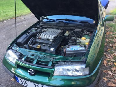

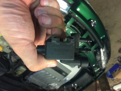

I decided to put some pictures instead of video biggrin.gif .
I had a problem with starting like i told on the video.
I had my friend change it and after that my fuel tank vent valve problem went away.One time after the change engine light came on,but when i floored it,then it went away and its still ok.
Also when i got it changed the fuel consumption went down quite a bit.
ps.I dont know why it it showing picture upside down.When you click on it,then its right way.

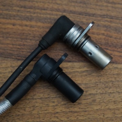

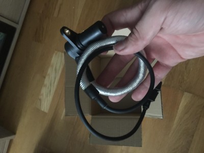

It was time to fix my baby,so i changed the crankshaft sensor and also made a video about it.
https://youtu.be/eYWDq3f6V8U
Also few pictures.
 Dateiname: 243100712_911848263099072_5621122899268281417_n.jpg
 Dateigröße:  349.12 KB
 Dateiname: 246863119_2933844670161093_3259502424875210730_n.jpg
 Dateigröße:  190.33 KB
 Dateiname: 247294460_885387378781028_6704644127619002463_n.jpg
 Dateigröße:  339.86 KB
AntHraX
Dabei seit: 21.01.2005
Beiträge: 1123
Danke-Klicks: 17
Wohnort: D-Hannover
Auto: C25XE
Beitrag: 762708 Geschrieben: 21.10.2021 - 21:03 Antworten mit Zitat Sende EINEN Danke-Klick für diesen Beitrag Back to top
Good to hear, the engine runs well. I had a similar problem some weeks ago, but my V6 didn´t start at all. Funny thing is, that you have the "expensive" sensor from opelteilekrause biggrin.gif which seems to work in your engine. With hat sensor my engine started, but didn´t run good and even died when in idle. I had to buy a genuine GM sensor for150€ and now it works perfectly. But I guess you have a X25XE? Mine is a C25XE and the former sensor even looked different. Funny that Opel even changed the screw that holds the sensor in place (E8 vs. allen screw) biggrin.gif In addition, I had to cut the wire of the sensor because it was below the oil cooler pipes and both socket and sensor were to big to get them out under pipes. After cutting the wire I found the broken isolation on the sensor. I guess due to heat from the oil cooler pipes for 25 years.

Good to know that i am not the only one who had this kind a problem.Also like i mentioned in the video.When the wire was near the spark coil,then it had the same problems like your.Didnt idle good and finaly died.
Beitrag: 762717 Geschrieben: 22.10.2021 - 17:24 Antworten mit Zitat Sende EINEN Danke-Klick für diesen Beitrag Back to top
meisner hat folgendes geschrieben:
We had that issue with a X25XE Calibra ja.gif only an original sensor could fix it. We were lucky, there was a new one on ebay for sale.
Regards
meisner
Dabei seit: 25.04.2006
Beiträge: 65
Wohnort: EST-Tartu
Auto: calibra 2.5
Beitrag: 762718 Geschrieben: 22.10.2021 - 18:57 Antworten mit Zitat Sende EINEN Danke-Klick für diesen Beitrag Back to top
Good to know.Luckly i found the solution by moving the wire😁😁

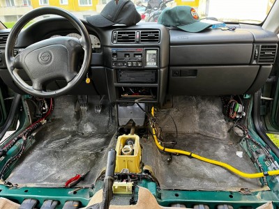

I'ts been a long time since i made a calibra video,but i wanted to share with you a new video.
Calibras new interior and how to change it
 Dateiname: 281293909_1200345737173115_6279770956001224296_n.jpg
 Dateigröße:  560.41 KB
Beitrag: 764336 Geschrieben: 06.06.2022 - 20:20 Antworten mit Zitat Sende EINEN Danke-Klick für diesen Beitrag Back to top
Yes, we alle been at this point biggrin.gif when I had my first Calibra, I changed from Mexiko to Black Leather interior. Of course I did some other upgrades, too ja.gif sometimes I really miss him traurig.gif
