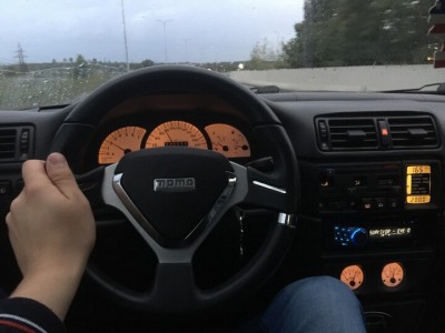

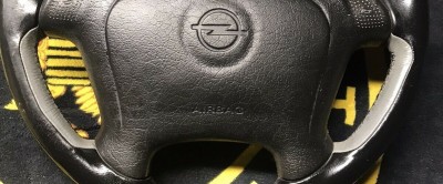

I dont mean your joking.I asked that like this because i’ve seen other kekes what has just normal steering wheel without silver.Maybe its worn off or if it is a sticker or something from the factory,then has come off. laecheln.gif
Beitrag: 758317 Geschrieben: 21.08.2020 - 09:05 Antworten mit Zitat Sende EINEN Danke-Klick für diesen Beitrag Back to top
As far as I know, the silver "inlays" steering wheel was an option ja.gif there are many Keke Calibra without it.

Can anyone in this forum tell is the silver part with leather or just put on?
This grey leather application is stitched, see picture attachments.

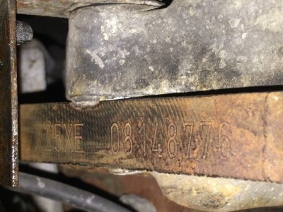

Here is a little update.
I checked the engine code it is X25XE.Only difference on the engine is that lower block just has bigger oil channels then C25XE.
upper part is the same for all of them.I also wrote to main capital dealer to get info about my calibra.That info should come maybe tommorrow.

 Dateiname: large_29872295_3Enp.jpg
Here is the engine code what i found
 Dateigröße:  114.99 KB

regarding engine Its the X25Xe so yes smal different with the c25xe:
X25XE block runs with a higher oil pressure due to using a larger diameter oil pump rotor. The oil pathways are larger in the X25XE block, and inlets are different.
Stock Opel Cams
C25XE : 4 x 'A' Green inlets & 'A' Green exhaust cams
X25XE : 4 x 'F' Brown inlets & 'E' White exhaust cams
for the rest completely the same.

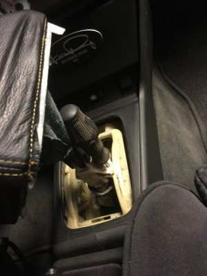

Regarding your gears in the video see first how much clutch you have on the padel?
when pressing down on floor when does the car start pulling when letting pedal come up while your foot on brake?
do you feel it after lifting it a little , lets say 10% 0r 30% or 50% pedal up? because that will tell a bit more.
Is gear stick going in middle after taking it out gear, lets say neutral? or a bit more to the right?
As i had hugh issues in the past but now even a fly can change my gears LOL.gif

It looks like your clutch and gearlinkage are not set correctly!
Here you have a file where you can see how to adjust that.
when you will block gearbox to adjust the linkage use an L-key tool and not a drill, because if that falls in the gearbox you have to take it off.
If you have any questions on how to do so, leave me a privat message.

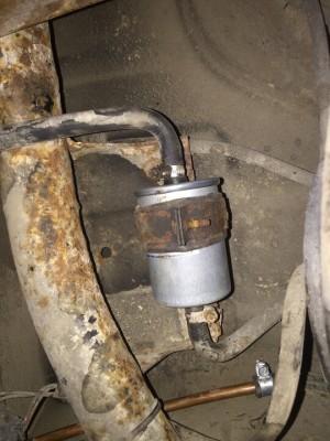

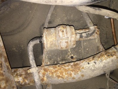

So finaly i got the gear linkage problem solved.
Again thanks to snowhite for the info.
I also changed the fuel filter because last time it was changed was over 3 years ago.
Oil and other filters will be changed soon because 8000 is driven right now after change.

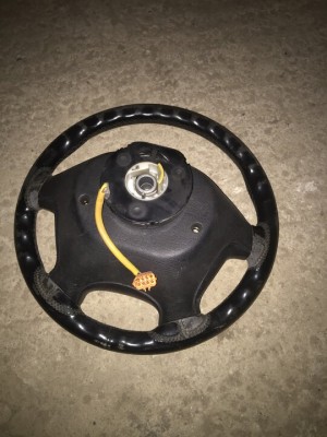

When the car came to Estonia the other steering wheel was at the trunk.
I will restore it but that will be sometime towards spring because money goes out a lot zwinkern.gif
 Dateiname: 1.jpg
Problem was that the linkage was adjusted wrong.

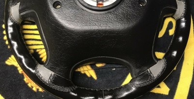

Also i checked the orginal steering wheel what i got with the car and it is a keke pattern just worn out.
 Dateigröße:  98.81 KB
 Dateiname: 6.jpg
 Dateigröße:  102.48 KB
